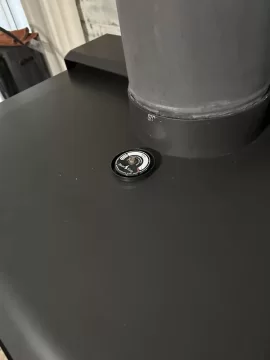

Well it has been a while. Installed new stove. Been burning since November 2023. I have done maintenance and cleaning regularly. Was cleaning behind the stove today and noticed rust and small hole on the new stove. Yes my wood is seasoned properly. Over 2 1/2 years dry. Wood reading moisture between 12 and 16% unsure what can be done gotta get the paperwork out and see if there is a possible warranty but i doubt it.

That's black. Rust is brown?
Do you burn one (half) load in high at the end of a season and brush the walls with a steel brush to get rid of the creosote in the box?
Creosote and summer humidity are killers for steel. And every BK.has creosote in the box...
Burned high end of last season Scraped box and wire brushed it and cleaned behind baffles. Also when stove was new ran a large bead of stove cement across the back of the stove brick.

Are you in an underground salt mine? Kidding aside I have noticed the inside of mine thinning out in the bottom right corner. It is now an annual maintenance item for me to remove the back bricks and inspect behind them. The tar that runs down back there as noted earlier in this thread cannot be burnt out with a hot fire.

Figured it out owned the stove since 10/13/23 . Has me worried. I did email the company to see if they can help.
That's surprisingly fast considering the stove only has 2 seasons on it.
Hate to see this.
To be clear, this firebox rust is on the part of the firebox that is at the very bottom of the stove behind the brick right?
How does it look on the inside? You say it's a hole so can we assume that you can actually poke a finger through?
Is there any chance that during the off-season liquid water was running into the stove from the flue and accumulating in the stove bottom around those bottom bricks?
You are correct about the location.
Didn’t remove the brick stove is running. tossed some JB weld on it since I found it when a fire was going. It is the very bottom behind the back corner brick right hand side looking from the front.
The stove was not attached to the chimney removed it after the season cleaned out the ash scraped everything cleaned behind the baffling. I had 2 dehumidifiers all summer long in the basement. Contacted Blaze king was told to contact the dealer I purchased from. The reply was that this is a very rare situation. I did look today the wood I am burning is from 1/23 .
