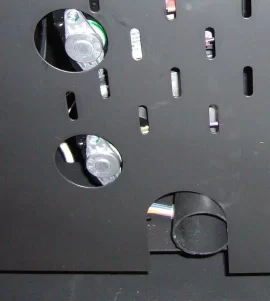

Has some issues. The paint on the top is marred. One of the metal straps that held it to the pallet was loose. Some of the paint is scraped. Maybe I can get Englander to send me a can of paint. A bigger issue is that the back panel does not fit. Partially blocks the included outside air kit. Picture below.

Got the back panel to fit. Kind of. It is not square with the stove and overlaps a bit. The knob has to latch from the top side to close properly. Got this from the included video. The video and user manual came in the pellet hopper. You need to twist the hopper door hold downs to open it. Is the metal plate in the burn chamber supposed to lean towards the front of the stove? Mine does.

Yes, the top of the plate should lean forward. Also, if there is a cut out area on the plate, it should go towards the top.

I am more concerned about the back panel not fitting. I will be checking the stove for 'square' in a few days.
NO!!!!! thats just for the 25-pdv , not the pdvc , the 25-pdvc should hang flat up against the back wall and hook to the ledge in the top back. the 25-pdv (larger stove) has a different baffle described above.
