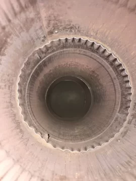

So once it quit raining I went up and gave the chimney a thorough scrub all the way to the stove. When I pulled the pipe off the stove top I had a pile of creosote, like 2 hand dustpans full! Never seen that before. And not the usual light fluff I get, this was round and larger, crumbled in your hands and coarse. Even my pipes near the stove were filthy!

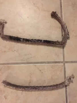

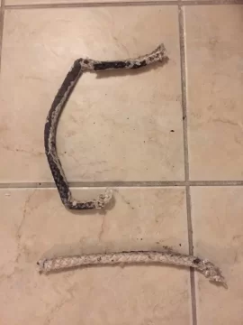

After a good brushing I inspect the pipes, all looks normal, then inside the stove. Not sure if part of my prob was that the bypass gasket was stuck to the bypass and lifting up, or this happened when I suppressed the heat down with the fire ext. Either way it was toast! Thank god I’m over prepared and have all spare gaskets for the stove on hand. It was baked in the slot so hard I had to scrape it out at the back and sides, front by the Cat was fine. The ext material was right at the back so maybe a reaction with the heat and material I figure.
So she got a fresh gasket, vacuume out and a checkup. Just firing it back up now, split up some nice dry kindling and it lit up perfect. See what happens, I’m the Kind babysitter tonight lol.
Reactions: Woody Stover
What’s left of the bypass gasket
