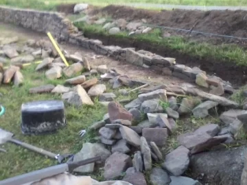

Here is what the process looks like early on. I have a rolling elevation change up to the road. That is what I am removing to create a 90 degree joint at the wall. First I have to dig out the the face of the hill, then build it.

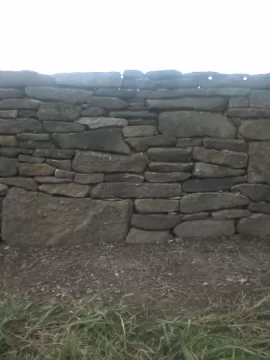

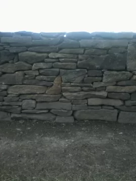

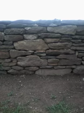

Well I made it to the tree that was the my target for the summer. Somewhere around 75 linear feet of wall. Only issue I have is the workmanship, or style evolved a bit over the last 10 feet. I must have been to picky with the stone I picked, and/or took too much time mating the stones. Either way, I think I will be taking a cold chisel to this portion to open up some seams and gaps. See the difference:

Not much at all B and thanks for the compliment. The extra time selecting stone helps, as does slowing the laying process to a crawl I would typically spend 45 minutes in the morning putting some mortar in behind and under the rear of the stones, done in a way to tie the rear support stones to the face stones but limited to not show in the front. The mortar cures while I am working and then if the energy and climate allow, I will pick the next course out for an hour or so at night. A course is roughly 12 feet wide, maybe 20 stones. The only cutting is done with a hammer to form the edges. I cut high spots down when needed with a cordless 4.5 inch grinder with a diamond wheel. Maybe chisel off some odd spots too. I would say one in ten stones gets a trimming of one sort or another. Every 2-3 courses I will load up the back side with bad stones and sackrete for stability. There will be lateral pressure on the wall so I am maintaining a thickness of 15 inches through most of the hieght. Is the difference as easy to spot as I contend (pic 1 vs 3)?
...Is the difference as easy to spot as I contend (pic 1 vs 3)?
Not to my eye in those pics. I know what it's like to have my nose buried in the details of a project and really sweat the small stuff. Later on, after I've been finished for a time, I look back on it and can't see what difference it made. Before I went after it with a bunch of chiseling, I think I'd just get 'er done, back away from it, live with it for a while and then see if it even still bugs you. Lookin' real good to me. Rick
You know- I think you should leave it! This wall will live a looong time, and the change in style/skill is really a great story written right in there. Imagine 2-3 generations from now people looking at it and telling the story of the guy that learned as he went.I love stuff like that
By the way, the early stuff STILL looks great.
edit: I have a few projects where the same thing happened. I recently made an evolutionary series" of skulls, and because I haven't sculpted in a while, they got better as I went. I went back and made replacements for the ones I started on- I can appreciate the pride you're showing in the work.
You definitely got better at it as the time passed, but it all looks great. I wouldn't change a thing.
Reactions: ScotO
I see the difference from one pic to the next, but willing to bet that if I saw the whole wall in person I'd see a gradual change in the fit that would not look out of place at all.
I'm with AP. I like the evolution. Reminds me of touring Inca sites in Peru, seeing the stonework evolve from the early style which was merely excellent to the later which was stunning.
I too have gone nose-down into projects & sweated details too much. Your eyes are seeing small differences as glaring and maybe seeing small things that no-one else will ever notice. Seriously, you're worried that the later part is too good! Why not just view it as your masterpiece?
