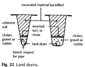

MWN, I would consider putting down a slotted drain pipe in a bed of shale at the bottom or up a third of the way on the backside of that wall. Put down a shale base, lay the slotted pipe down, put some more shale on that, put down some good landscape fabric, top cover with straw and dirt. Slope the pipe around 1/4" per 4' or so. That would go a long way in helping that wall last even longer......

That is a great idea. Right now the entire back of the wall is exposed so the task is quite easy. Thanks a ton for the tip. Will post pics when I do it.

You bet brother. That will give you all kinds of drainage.

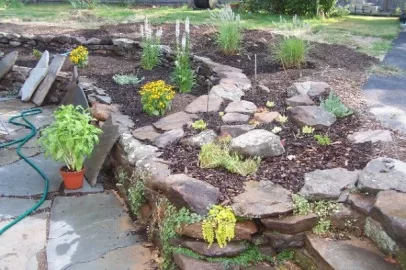

Looks good. Nice balance of rocks & chinks to fill in.

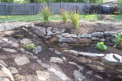

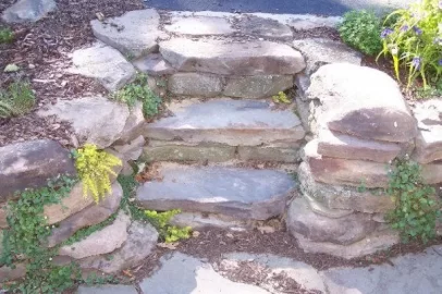

My attempt a few years back, still holding strong, all set right in tamped sand, sand is about 10 ft deep, well thats as far as I ever dug.
I love it! The beauty of natural over interlock and precast in an application like yours is that it actually looks better with age. The stone acquires a natural 'patina' and hopefully a fine moss will fill in all the gaps.

Nice work myway. Very nice. Thanks for the pics. Did you buy that stone? Or is it on your property?
