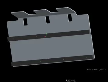

I just purchased a 118 (197?). It's the non UL model with 2 hole pattern burn plates. The plates are a little warped and have a couple cracks near the hanging holes. I could probably get a year out of them as is but I'd feel safer replacing them. The cost of new is crazy and would make the stove a bad investment . Is it possible to make some out of plate steel either galvanized or stainless. I have some scrap steel at work and I modeled the plates on cad. I actually modeled them as newer UL plates with 3 positions. What would be the concern being made out of steel? I have either .125thk or .200thk to irk with.

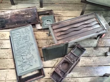

I tore the stove apart this afternoon. I'm going to resell the whole thing. There were a ton of light leaks so I figured I should rip it apart. I did break 4 bolts but I sort of figured some would break. It's green enamel and has some small rust spots where there were scratched.would it be safe to paint over the enamel with a high temp paint ?
If it were my stove I would get cast iron burn plates. They should last longer and also may fit better against the baffle. My concern with steel would be warpage. If you choose this rout use the heaviest gauge you can.

I was thinking about ordering new but the cost is crazy. I think the shields alone would be about $500.
Here is a quick draft of what I was thinking.The shield would have a relief bend at the bottom to add some strength and would also have 2 pieces of steel running across the length. The cost to it like this is probably about $60 in material and my time to cut and bend. I guess my main concern would be if I am protecting what its there for.My guess is that they are there to help protect the cast sides ?
It should work as protection but I wouldn't expect their lifetime to match cast iron. Steel tends to warp more easily.
Your question is not uncommon. Give it a try and keep us updated on how they work out after a few seasons on them.
Thanks begreen and I do agree it wont outlast the Cast. Is there a reason the production shield does not go all the way down to the bottom of the firebox? Its sort of a strange design IMO.
Also what would you do for painting? Im fairly sure anything I put over the enamel will flake off and look twice as bad as it does now. Could I simply use engine enamel paint right over what I have ? Or is better to first use a high temp primer and paint over that?
Thanks so far this site has been great for feedback.
The burn plates only cover the hottest part of the fire box. Put in at least 1/2" of clean sand on the bottom after the rebuild.
