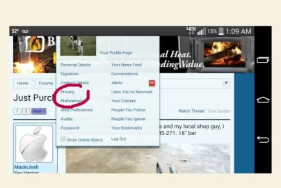

Could someone also tell me how to disable the constant email notifications? I've scoured the settings and even clicked on the link in the emails and nothing is working. Thanks.
Its under preferences
[Hearth.com] Just Purchased My First Saw
Just uncheck the box.
