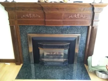

This is what the new insert will replace. Propane Vermont Casting.

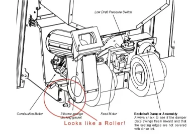

I do also wish it was on rollers. This is a very nice feature.
I was just looking more closely at the insert. It appears though it does have rollers on the back! Not 100% but looks as though. Yes, the temp probe can be located elsewhere. The temp sensor works as a resistor which senses the room air temp to allow the stove to ramp up and down as it it gets closer to the set point. There are a bunch of modifications which can be done to adapt a set back for nighttime temp and or use a tstat to operate the stove but you will get 4 blink error codes when temp is achieved and no ramp to a set point. Easier to explain in person.
