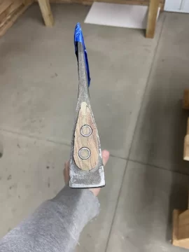

Finished hanging it today. I regret using a bought wedge. It was poplar and soft so it was a struggle to drive it well. Wish I could have drove it a little deeper before it started to break up. I still think it will hold well. Never used to conical wedges before so we'll see how they hold up.
Just a little painting left on the handle, maybe stain and then linseed oil.
