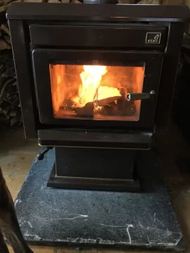

I had a kent and thought it was ok the secondary burn processes is something like today’s stoves pretty neat ahead of their time. I would say any new stove that heats 1200 squares would replace that particular Kent you mentioned. I find Kent’s all the time on craigs they seem to be posted for 300$ I bought mine for 150$.
  • [Hearth.com] Kent Sherwood - Wood Stove information

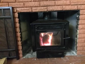

Our Kent, sold recently for $150 with a warped baffle, was able to heat most of our 2400 sqf home. GREAT stove!
And yes, on CL for 250-500 frequently.
