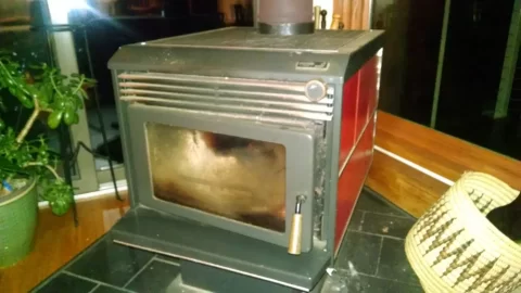

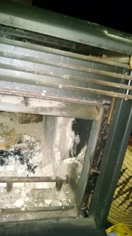

I thought the Kent Tile Fire didn't have firebricks, unless this is an Ultima. Does the stove have a flat or an bay door front? A picture or two showing the stove and showing the crumbling interior would help us see what you are seeing.
Thanks for the help! Here are some pics. Hopefully these will come through.
[Hearth.com] Kent Tilefire 2000 with the crumbling walls? [Hearth.com] Kent Tilefire 2000 with the crumbling walls? [Hearth.com] Kent Tilefire 2000 with the crumbling walls?

I'm hoping you don't fire it up with those plants and flammables alongside. !!!

thanks for the info. I will go to Kent's website and see if I can buy a liner and have someone install it. Thanks also for the fire safety tip! I do try to keep the plants and baskets away--its still early in the season. Speaking of fire safety, you sure its okay to tun the stove with the cement off the walls? There is some fibrous like insulation that is exposed? I guess that must be very flame resistant yes?
BG, I don't know how you do it, but something compelled me to log on this morning. The 2000 was an interim model, marketed for a short time between the Tile Fire LEM and the Ultima. The sidewalls were lined with ceramic blanket material behind custom cast refractory panels, to increase the internal firebox temperature for more complete combustion and lower emissions. If memory serves, the side panels also supported the arched cast refractory baffle. It doesn't look like the panels are able to support anything at this point, so the baffle may be gone. Kent is long out of business, and I know of no source for side panels or baffles (the Australian company Pricotech purchased the trademark, but never made a Tile Fire). The stove should continue to function without the panels and baffle, but at very low efficiency (incomplete combustion, no secondary burn). Further, with those parts removed, both the EPA emissions listing and UL side clearance listing go away. It might be time to consider putting that old boy out to pasture.

Wow, Mr. Chimney Sweep--that is very helpful and sounds right to me. Of course the stove is old and both of the sides are bowed inward and cracking off as if they have lost all support. I think that I will probably take your advice and put our old friend out to pasture. Since getting on this site I've been investigating some of these new fancy stoves. We live in a very contemporary house and I LOVE the Rais stoves as well as the Hearthstone Tula. All pricey but lovely. What recommendations do you have for contemporary stoves? We use them often, but not as our primary source of home heat--mostly family time and dinner parties. Thanks again for all the smarts.
