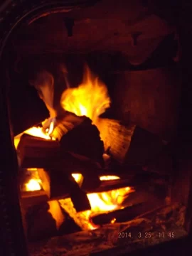

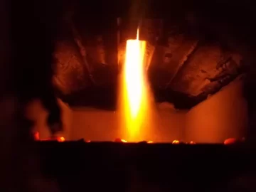

20% MC wood, wet basis, is 10 parts wood, 2 parts water. 40% MC wood (for example, green winter locust) is 10 parts wood 4 parts water. The energy required to convert the extra two parts of water to water vapor and send it up the chimney only amounts to 3.5% of the energy produced by burning the 10 parts of wood. This assumes complete combustion with no smoke, as in the photo.
It can be done, maybe not in a wood stove or [see below] an OWB, but it is fairly easy to burn green winter locust correctly with reasonable efficiency.
I was guessing something like that. Unfortunately such complete combustion of wood at 40% MC is well nigh impossible in many woodstoves, which makes blanket assertions problematic.
