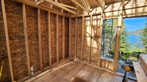

We're adding on to our house and getting a King 40 with ultra base installed in the new space.
Our contractor has experience installing/building stoves and fireplaces, but isn't familiar with Blaze King. I purchased the stove a few months ago, but haven't ordered any pipe as we only had a rough idea of where it was going to be situated.
Now plans are beginning to firm up and more specifics can be made for the installation.
[Hearth.com] King 40 Install

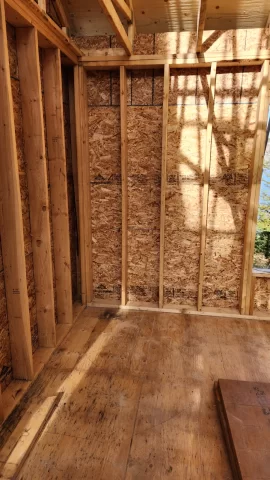

The stove will be kitty cornered in the new space and we've roughly worked out where the pipe will go straight up through the roof - between the first and second joist (first joist is 2ft from the wall). The roof is a 12/6 pitch and metal.

What pipe considerations I should be aware of for cleaning and performance? Obviously all insulated pipe to maintain heat and draft. Would a telescoping piece be advisable? Or keep everything as fixed as possible and clean with a sooteater up through the stove.
While the 12/6 roof isn't overly steep, the location near the edge means there will be a good height of exterior pipe that I'd rather not try to get up above every year.
The pipe will be on the windward side of the roof, which faces the lake and sits on top of a slope (30ft above water level). Prevailing winds are from the northwest, and the house/roof faces northest, so some wind will be climbing the up the hill and up the roof, presumably causing some increased pressure. There are some trees and hills to the north and west so we're out of the line of fire for the worst of the wind. Approximately how much added height should be added, or would that be negligible?
Any other things I should be cognizant of?

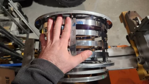

What are people's thoughts on this rain cap with regards to creosote buildup? Should I trim some of the bands to reduce places for creosote to deposit?
Part CVA-C08
Obviously the wide gaps are much better than a wire screen, but it's a lot more material than just a raised plate to stop rain from entering the pipe. But with a 13" diameter it shouldn't cause much resistance to exhaust flow, even with some buildup.
Obviously it'll stop birds from nesting, but could it also provide some downdraft protection from wind? Any other potential benefits?
Thanks!

Olympia Chimney manufacturing is based in Pennsylvania. ICC is based in Canada. Both are great companies to work with.
As for the cap, the fewer the bands the better.
BKVP
Reactions: Quirke and moresnow
Personally I’d leave them on until you have a reason to remove them. The biggest reason to leave the bands on would be the WETT Inspection, by altering the cap you have modified the OEM design and possibly giving the inspector a reason to fail the inspection or at the very least question you on why you altered the cap from the original design.
If you’re running the stove as per BK instructions with good dry wood you shouldn’t have issues with creosote buildup, where you might have issues will be in the dead of winter with ice buildup, then you could consider climbing up on the roof with a pair of tin snips. When I get ice buildup I open the thermostat to high for 20 minutes or so and that takes care of the ice.
This looks exactly like the cap we have, and it's been flawless for the last seven years since it was installed.
No issues with clogging, and it cleans well when running the sooteater through from below.

Nice. Given how the slots are attached as a structural part of the cap I think I would try it first before cutting. Just beware and ready to clean that thing off in the middle of the winter when flow is further diminished.
If you had the option to remove a useless screen then I would recommend that unless your local regs require it for the alleged ability to filter sparks.
Me, too, those metal strips look structural to me as well. I'd try it as-is, you can always remove one if it doesn't work out.
