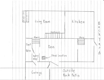

Trying to decide which one to install in the house. Square footage is 2200 plus about 800 in the basement. I'm in Louisville, KY and so we don't normally have bitter cold winters but we can have stretches of really low temps. House is a tri-level with all 3 bedrooms upstairs. Stove will go in the den which sits at ground level on a concrete slab. Living room and kitchen are elevated from there and sit above ground. Basement is underneath living room and kitchen only.
Below is my crude sketch of the bottom two levels of the house. Primary wood to be used is Ash. There's dead Ash everywhere around here.
