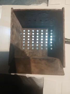

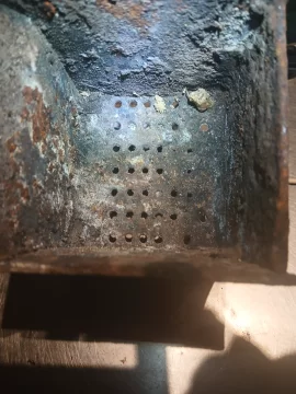

I Paid $250 for this King PK130 from a woman who said it started to smoke after 4 good yrs, she panicked and bought a new stove.
But I can't test it until I get the exh pipe hooked up.
Meanwhile I'll give it a thorough cleaning and vacuum everything.
