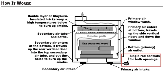

Thank you for posting the manual, I did skim it before my OP. It has a simple (but inclusive) diagram and it locates the "Single rod controls for both openings." However, I am wondering if this is the only thing that needs to be opened.
In the manual it instructs users to "Open the primary air slide by pulling it all the way to the right." It is probably fair to allow the technical writer to assume the reader will translate this to "Pull the Rod Controls all the way to the right to open the Primary and Secondary Air Intakes." Or maybe I totally misunderstood the document.
My question: Is the primary air slide the only vent for this stove? I am sure it can be modified at user's discretion, but by default is this the only damper?
I am also wondering if the Magic fan thing needs to be open or closed (and how is this done: push or pull?). I understand leave the fan off, but does it need to be adjusted to a particular position for air flow?

As far as the stove goes - news paper, fire starter kindling, open the air control all the way (primary air) get the fire going (helps if the door is cracked open (just un latched) close the door after the fire is established, keep the air setting open, let every piece of wood catch real good, should take in the ball park of 15 -20 min, load a few more pieces in, start pushing the air control in slow increments. The is no controlling the secondary air, it happens automatically on this type of stove. As the primary air gets closed off it creates more heat in the fire box, the secondary's kick in once the box gets to a certain temp, then you start getting good heat that radiates off the stove, you should have a stove of chimney pipe thermometer, it will help you keep track as your learning the stove.

Hi Carbon- Yes if its an Enviro 2100, its a beast. Does it have the brick baffle in top and are they in correctly?? If the chimney was cleaned, was the the stove pipe removed from the stove and the inside top of the stove cleaned too?? It can be blocked if swept down... Air control to the right (all the way out out is fully opened, left is minimal air). Have installed a few of them, they are a serious heater, but would suggest losing the magic heat, it'll just cause chimney problems.. Good luck with her.
Thanks! So what I gather from your comments is: Yes, the Rod Controls is the only adjustable damper (is it really a damper since it is on the intake?). Please confirm.

The Kodiak 2100 has only one air control. It regulates the primary air and the secondary air. The secondary air tubes are restricted by the small holes that need the vacuum of good draft to pull air through them. For this reason and the fact that it is cooling down the flue gases, the Magic heat should go. It was designed as a bandaid fix for old, inefficient stoves.
