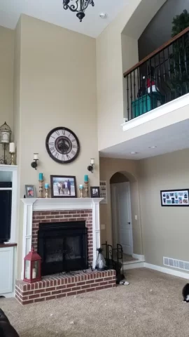

Newbie to the forum here love all of the info. I have been doing a tone of research for a new project that we are do. We are going to replace our crappy zero clearance, prefab with something that will actually produce heat. So I just wanted to get the thoughts of people who have much experience.
Our house is approx 3600 sq, with a very open floor plan. Living room where the stove will be has 18' high ceilings, with a balcony to the upstairs. I will post a few pics of living room.
We are hoping to get something to keep the whole house warm to minimize the amount of propane we have to pay for. The wood is free and great exercise for me.
We are considering the three choices above or up for any other suggestions.

Are you looking for an insert or freestanding stove?
I have recently installed a Sequia and it is a great stove. It is super simple to operate and maintain, and puts out a ton of heat. One thing to note is that this stove requires an 8" chimney. I suggest installing as a freestanding stove so that you may add dampers because it sounds like you will have a tall chimney which will lead to overdraft issues. I had this issue with my installation.
You may also want to check out Woodstock Soapstone, the Ideal Steel is a big stove and very well made.
At this point I have not seen a insert that I feel will have enough umph to do what we would like for it to do. Also I am pretty sure I will have to replace my whole stack completely anyhow. We had considered the Quad 7100 which is a prefab replacement that has some pretty good specs, however I think we are leaning more toward freestanding for cost purposes and its seems to me that we will get more heat out of it. I have also investigated the woodstock stoves some but was concerned that they may not put off as much heat as some of these other large stoves. I do kinda like the looks of the progress hybrid, and the ideal, but was a little concerned with the heat output. Most due to their sqft ratings. I understand that can be subjective but just want to make sure we do not tear apart our house and install something that is not as good as it can be.
I have a freestanding Kuma Sequoia in my basement it is a heat machine. Until the house gets below 30 it heats my whole house which is 2450 sq feet on the first floor and with the finished basement is over 4000 sq. It does have a 8 inch flue and as stated above it does have certain draft issues depending on your install. Overall I love the stove great burn times 12 plus hours, sometimes longer depending on wood and size.

Are you married to the carpet? Is your house on a slab? I forsee a freestanding stove eating up quite a bit of living area square footage if that's an issue. We are talking about some huge stoves here.
Reactions: Woody Stover
Thanks for the help guys, as far as the carpet goes my wife hates it and I told her that if we redo the fireplace she can have new floor, she what hard floors.
I do understand that those stoves will take up considerable real estate, so we will have to make sure that I mock it up with card board or plywood first to get a better feel for flow. We also will be partially removed the chase so that will give us an extra 2 feet.
