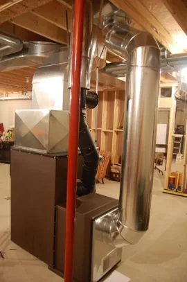

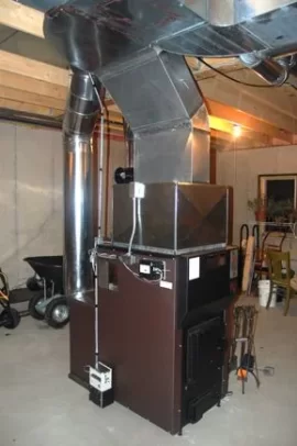

Just got my furnace installed and have been burning for a day. My first impressions...I am really impressed! So easy even a caveman can do it. It is totally computer controlled and all you have to do is put in good seasoned wood.It controls the draft completely and burn times have been 8 and 8.5hrs. with cherry.Thermostat set to 70. 1840sf ranch No temp. swings mark on 70 in the living room over entire burn and super even heat.Outdoor temp low 20's. Cant wait to see what a load of hickory or white oak will do. The company answered questions when called right away and talked with me as long as it took they knew the stove, electrical connections, plenum, chimney, everything...like the back of their hand, and even called me back when my cell lost call. They tried 5 times! and ended up calling back to my land line house phone. Now that is customer service. This furnace blows no smoke, has ultra insulation( can touch its outside and is just warm). Two layers of firebrick and under that ceramic liner. also stack temps are super low. can touch class a 3 foot above the stove. but box temps are prolly way over 600. The Kumma company is a small family owned place way up in Tower MN. they build these furnaces like tanks. And they are not inexpensive but in this case you really do get what you pay for +... Extra heavy guage steel, high limit alarms, over abundant insulation and zero creosote with good seasoned wood( he told me he has yet to have to clean his chimney after running it 18 years) all these things made it worth every penny to me in peace of mind factor.

Sounds good, looks good, nice fire in the box keep us updated on wood consumption have you had wood burning heat in the past how does this stack up to others..Is it a boiler with a built in exchanger?? Dave
Had an old Franklin growing up and a Wards furnace for the Basement.Have used a hearth stone and jotul at uncles and parents. This is not even in the same Universe as those. This thing runs like it has cruise control and does everything all by itself. it adjusts up and down with load and output. it is a forced air furnace. No boiler. Biggest thing I have noticed so far is how even it keeps the temp in the house. The old furnace I grew up with would have huge swings and very little way to control output. This Kuuma Vapor fire 100 controls intake air, damper, and heat output precisely down to a couple of degrees. It burns the logs right down to nothing without changing the temp in the house until it is out of fuel. Has led lights on the computer that tells you what is going on at a glance from across the room. Dont see me having to do much tinkering and has almost zero learning curve...unlike a lot of others. Almost disappointed that there is so little to do to get really good burns already....Almost.
Anyone else want to comment on my install?
Photo's too small to see, but looks like every air and vent connection had to be offset a little? I have thought about a wood furnace rather than a stove, and am wondering if you have central a/c in your house or if this is a stand alone system? Do you have a backup heating system, if you do, what kind?

Thanks for sharing the photos. That furnace should keep you warm this winter.

Sorry I didn't reply to your questions...must of missed it. Kumma recommends using 2 45 elbows off the back if possible and not 90's because of the low stack temps. the intake air and plenum were just brought back to fit joists and rafters and existing duct work.(chimney is right behind the jack post in photo) We have a train 93eff. forced air gas furnace that ate us out of house and home last winter($3400 bucks and we froze our butts off).We figure it will pay for itself in two winters and we are nice and toasty warm. This is the stand alone system because we set it at the other side of the basement from the gas furnace...near to walk out for ease of wood getting. They also make an add on model that uses your existing blower But I like the big, nice quiet fan this has.

Hi Fsumble, You are gonna just love it.Best money I have ever spent. I tied it into the return of my gas furnace. So that I can take advantage of the filters in the upstairs returns, so as to double filter the supply air for the wood furnace.(the kumma also has a filter box on the back of the blower housing, since you got the stand alone vaper fire 100 model)I also made a flap that swings and drops across the top of the plenum of the gas furnace, keeping the hot wood furnace from backfeeding in though the top of the gas furnace so I dont blow all my nice heated air back in through the top of the forced air furnace.It opens and closes automatically depending on the which unit( direction the air flow) is blowing.I also made a turn stop at the top of the wood furnace plenum so I dont backfeed hot air to the fire box of the wood furnace if I want to run the gas furnace. You Just need to remember to turn it to open if you start running the wood furnace again.
The vapor fire 100 comes with a separate thermostat for the wood furnace. I installed it right next to my thermostat for the gas furnace in the living room.One note, I located the sensor for the thermostat in the top part of the big square part of the plenum off of the top of the wood furnace as it was not heating up and kicking on the blower if connected right on the bottom of the plenum where the instructions tell/show you to place it. If you need any clarifications let me know, but Lamppa is just a phone call away and they are the most helpful folks I have ever dealt with if you have a question while installing.Good luck.
