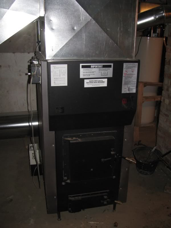

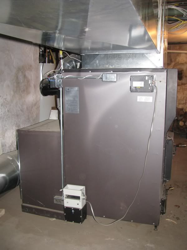

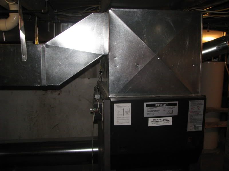

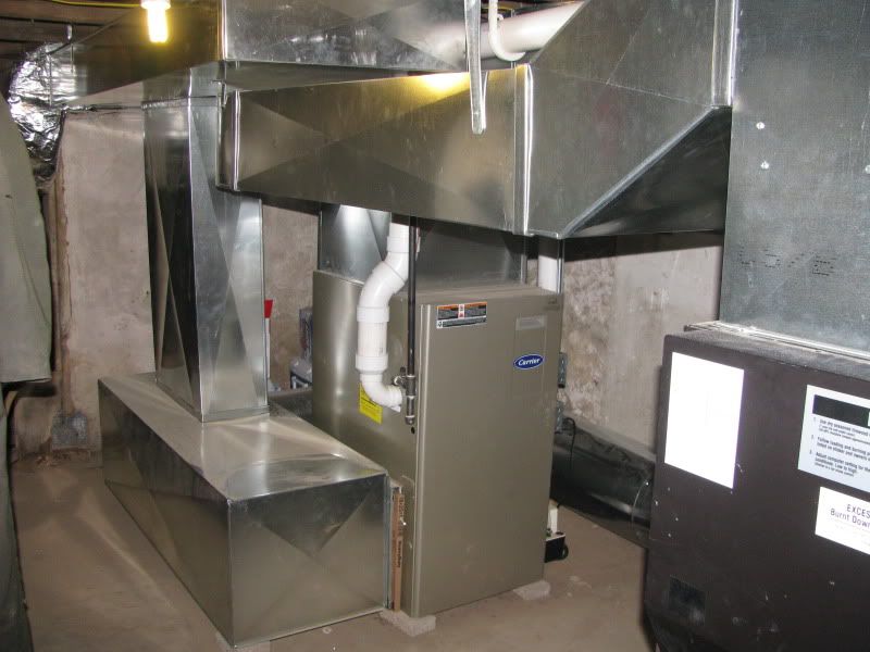

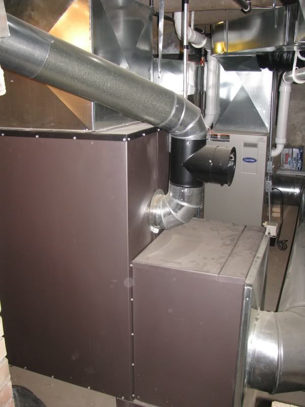

    Sorry for the delay....here are pics of my VaporFire 100.
    Here is a front view:
    [​IMG]
    And here is a pic of the Kuuma's red-headed stepchild...the LP furnace:
    [​IMG]
    The top front of the unit:
    [​IMG]
    Side view:
    [​IMG]
    And here is the back of the unit:
    [​IMG]
