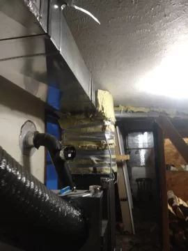

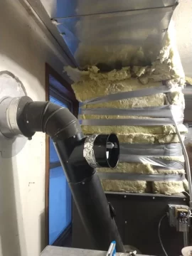

Why not post the pic here that you posted on that other forum? From that one, your baro damper is installed incorrectly.
Post that pic for starters. And maybe more. You will get more overall Kuuma specific feedback here - I think.
I agree...we need pics...from the pic you put up on AS, your return air is too small...IIRC, you need 180 sq in. on the supply plenum/ducts...and around 200 sq in for the return ducts...about 10% more than the supply.
You look to have a 12-14" flex duct there...so assuming its 14", that's only 154" sq in...and flex duct actually "flows smaller" than its nominal size.
I am thinking that it is not drawing enough. I leveled the damper both ways to see what happens.

I would straighten that stove pipe out...just use 90s so that the pipe is vertical and the baro can be installed properly...with 25' of class A chimney you will not have draft issues doing this (assuming that's why you angled it)
With the baro just taped on if you ever have a backpuff (unlikely with a Kuuma) that baro will become a projectile.
