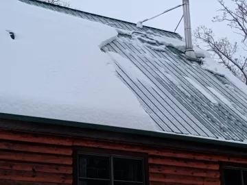

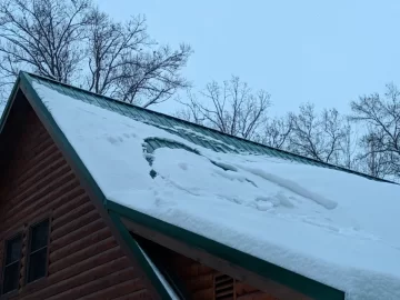

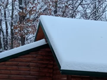

Here is the situation we have our Kuuma VF100 heating.
We got 9" of snow on Sunday. After I blew the driveway, I snapped these photos only a couple hours after it stopped snowing. Was 22° outside. There is supposed to be 9" of snow on the roof. Garage pic as a reference, as it's not heated. Front and back roof of the house. Losing a lot of heat along the whole length of roof peak. Our indoor humidity levels are also low..........but the house is warm.
Front of house:
Rear of house:
Garage:

I'm still honestly surprised your heating as many square feet as you are, with that much heat loss. Posts like this make me feel excited about the future when I get my house and furnace dialed in better.
JRHAWK9
Jan 8, 2014
2,004
Wisconsin Dells, WI
We don't have a very large house, square footage wise, but do have a fairly decent amount of volume based on the footprint. It's a 32'x42' footprint, but around 32,000CF including the basement. The basement is heated solely off of the radiant from the Kuuma. The 1/3 of it where the furnaces are stay right around the same as the rest of the house, the other 2/3rds of it is a bit cooler.
