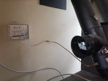

(broken link removed)
![[Hearth.com] Kuuma VF 100 not heating my house! Help! [Hearth.com] Kuuma VF 100 not heating my house! Help!](https://www.hearth.com/talk/data/attachments/256/256056-ac0db971e9a5a10c96da74a6dfdd58c9.jpg?hash=0XbN85zubq)

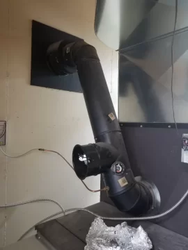

![[Hearth.com] Kuuma VF 100 not heating my house! Help! [Hearth.com] Kuuma VF 100 not heating my house! Help!](https://www.hearth.com/talk/data/attachments/256/256057-fab422a872ed99cd8b5b9a41e0b57ce9.jpg?hash=77o8NzW938)

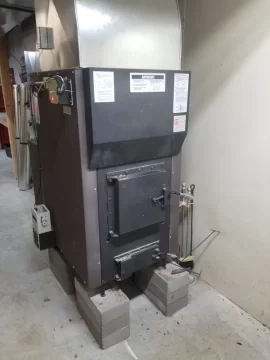

![[Hearth.com] Kuuma VF 100 not heating my house! Help! [Hearth.com] Kuuma VF 100 not heating my house! Help!](https://www.hearth.com/talk/data/attachments/256/256058-914f040707de3ed9f7d71a501e94fcbc.jpg?hash=v9bneQLzgK)

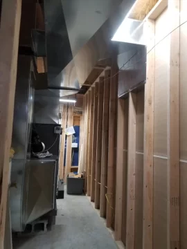

![[Hearth.com] Kuuma VF 100 not heating my house! Help! [Hearth.com] Kuuma VF 100 not heating my house! Help!](https://www.hearth.com/talk/data/attachments/256/256059-5217ffa01020b8adc3d6c7cdf00a6449.jpg?hash=mg1HhFdjqB)

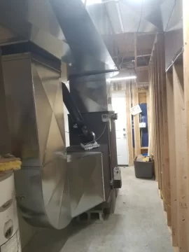

![[Hearth.com] Kuuma VF 100 not heating my house! Help! [Hearth.com] Kuuma VF 100 not heating my house! Help!](https://www.hearth.com/talk/data/attachments/256/256060-2174ce087426d748ed8f313b84b0121e.jpg?hash=fcxdusSrxn)

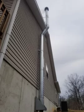

![[Hearth.com] Kuuma VF 100 not heating my house! Help! [Hearth.com] Kuuma VF 100 not heating my house! Help!](https://www.hearth.com/talk/data/attachments/256/256061-b1fc46f46f97293c224ec317a931bf64.jpg?hash=tckx0gid_M)
