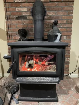

Thanks for the reply begreen.
Average reload time burning the day is around 4 hours to keep the house warm. Around 7-8 hours overnight.
Currently burning a mix of birch, maple, and ash. Exterior readings of around 10-16% just split some pieces and getting around 18-21% on the interior.
I was thinking a possible draft issue as well but am not knowledgeable enough on it. Never an issue starting a fire or getting smoke into the room. I have a basic flue temp gauge about 16” above the stove on single wall stove pipe. I currently have the stove at about 50% air and loaded it about 2hrs ago. The stove top is reading around 500 and the stove pipe is reading around 300. Getting some secondary burn. After loading the stove it takes about 15-20mins on high before I turn it down. I generally go to about 50% air during the day to try and keep the temps up and down to 25% overnight. Anything below 25% and the fire really dies down and the temps drop. The basement is insulated and about 80% finished.
I believe the stove is capable or heating our home better. Just not sure if the install has an issue, the stove has an issue, the wood has an issue or something else.
I attached a few photos of the stove, thank you for the help!

What model was the VC stove? The main differences between the two are that the VC is a strongly radiant stove and the Summit is convective.
Thanks for the pics and temps. They are helpful. What are the peak stove and flue gas temps during secondary combustion? Ideally, the stovetop temp will be about the same or a bit less than the flue gas temp. Double the surface flue temp reading for the approximate flue gas temp. At peak, our stovetop is about 600º with these long burns. Your stove temps are not that far off.
I would try turning down the air sooner and perhaps farther. This will encourage stronger secondary combustion and more heat at the stove with less going up the stovepipe. Our air is 90-100% turned down during peak burn. When burning hardwood this might be more like 85-90%.

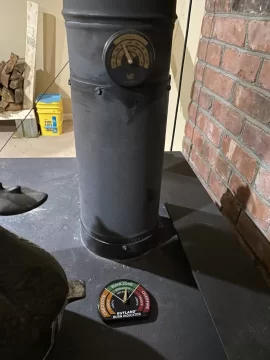

Thanks begreen and MR. GLO, I’m getting 600-700 degree flue temps on my single wall pipe with around 600 degree STT. It takes about 15-20mins to get to those temps after reloading the stove. At that point wood is generally glowing pretty red. If I turn down the air it seems to smother the fire and I lose secondary burn after a few minutes. Are you guys saying to shut down the air sooner?
Begreen, our old stove was a Vermont Casting Vigilant. It would get so hot we couldn’t stand to be in the room, the Summit has never done that. We do not have a blower on our stove, wasn’t sure it would do anything since the stove is in a 15’ x 13’ room.
If you have not doubled these temps for posting here, then that is the problem. 6-700º surface temp, means 1200-1400º internal flue gas temp. It sounds like the tall stack is sucking up the heat badly. A damper in the stovepipe may be needed to tame the draft.
That is ok, as long as some flame is present and persists. The fire will regain strength in 5 or so minutes.
Yes, the Vigilant is a highly radiant stove. Anything in line of sight with the stove is going to feel the heat radiating off of it. Much like the sun. If the side shields were removed from the Summit the effect would be similar.

Didnt Frozen VT he take the measurement from the magnet gauge?
Begreen - What do you want the flue temp to get to on first load ? and a reload with this stove?
Id get a flue probe or check with ir temp gun. 1400 would seem very high on this stove.
The location you have your STT magnet - I dont think it is the hottest location on stove. mine is in front of the pipe about 3 inches and left or right , 3 inches. find it with IR. Id get stt up to 650 and see if you get more heat. but use ir.

Yes, I just want to verify that these are surface temps on the stove pipe. I had mentioned the doubling in the previous posting. If they are the actual surface reading (and not doubled) then the internal flue gas temp of 1400º is very high. That's a lot of heat being wasted.
Our stovetop thermometer is about 6" to the left and 3 " in front of the flue collar.
Begreen, all my flue temps are not doubled and are the reading off the magnetic thermometer about 16” above the stove. Before I got the PE stove my chimney sweep was pushing for a SS liner. Since the PE he says my chimney is super clean, this makes sense give my high flue temps. I didn’t realize they were doubled! I just reloaded the stove and followed your EPA stove start up routine. The stove surface temp is currently around 575 and the flue surface temp is around 400. Should the flue surface temp be less?
