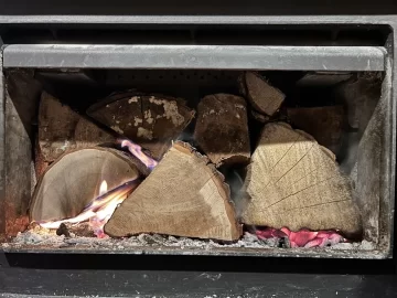

Just when I think I’m getting somewhere with this stove it seems like I’m actually not getting anywhere. I went out and got some nice kiln dried local firewood and the stove is running like crap. I made a quick video, im getting barely any secondary burn on high/medium and nothing on low. Hope this video shows my issues and struggles.
That's kind of a small fire. I wouldn't expect to see a 600º+ stove top with it. With the air set to high, you won't see any secondary combustion. There is not enough vacuum pulling on the secondary intake with all that primary air flooding into the firebox.

Sounds good. Also, add more wood. One layer of splits is not a big load.
FrozenVT
Dec 16, 2020
27
Central Vermont
Sounds goo. Also, add more wood. One layer of splits is not a big load.
Ya that was a bad photo, I generally load the firebox as full as I can.
