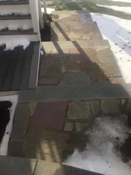

Here's mine, for reference. Are yours like this? These were done about fifteen years ago, and most have popped at least once since then. The problem is the grout behind the tread expands and shrinks seasonally, and then things like seeds and ice work their way in when the grout shrinks. Slow, but inevitable.

Sorta....the bluestone tread overhangs the riser like yours but the area behind the tread consists of pavers that lead to the next riser. I guess it's a similar problem with a different design. The bluestone risers have a dry stack look although they are held together with some landscape glue.
[Hearth.com] Landscape adhesive
I like that look a lot. In terms of failing it looks like it would behave like that series of steps in my third photo. There, moisture gets into the mortar behind the big bluestone tread, and slowly pushes it out. No adhesive on mine, fully mortared.
People like to think stone is forever, but it requires constant maintenance. I have a mason on-site maybe one week every year, doing various repairs.

The problem with pavers is as much from above as below. Seeds, whether it be grass or weeds, eventually work into the cracks. I have several flagstone patios here, and they are all mortared onto concrete slabs below, so not entirely like your boss's paver driveway. Each year, I have one or two joints to chisel out and redo, mostly from water getting in and popping a joint loose. If I don't keep up with the failing joints year to year, eventually an entire flagstone will pop loose from our constant freeze/thaw cycles.
Being a few hours south of you, our normal winter weather is just above freezing most days (eg. mid-30F's) and below freezing most nights (eg. 20F), all winter long. The daily freeze/thaw/freeze/thaw cycling is hell on masonry, much worse than staying frozen most of the winter.
