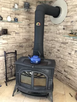

Thank you both for your replies. I'm sorry that I'm such a novice--we bought the house with it all installed, so I'm not actually sure if what kind of connector or if it is a single wall flue. How do I tell? I've attached a picture in case it helps.

Do you have a fan blowing on the stove?
Looks like the fire is in coals and that is where my pipe temp is at that stage. Does it get into the upper burn range early in the cycle when the flames are active?

That sounds about right. Your gauge is pretty high up on the pipe too. There is also quite a difference in temps from where the pipe exits the stove to where it goes into the chimney as well.
I can attest! Try lowering the gauge about 4" and see what you get.
Your flue temps....once the stove is up to temp and cruising....will be fairly close to your stove temps. Meaning if your stovetop temp reads 500 or what have you your flue thermometer will probably be around 250....which actual inside of flue would be around 500. It reads around half of actual temp because it is measuring the wall of your connector unlike a probe thermometer that is reading inside of the pipe.

Agree with prior post, for pipe temps you're a bit high. I think 18" up from the collar is what I've read.
250º surface temp on single-wall is about 500º interior temp. That's a good temp to see there during the wood outgassing (flaming) stage. During the coaling stage, it's ok if it drops lower. You could try moving the thermometer to 18" over the top of the stove to see if that makes a difference. You could also try a different thermometer. Rutlands can be off by a bit.

The thermometer should be 18" from the top of the stove. It looks much higher than that.
