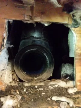

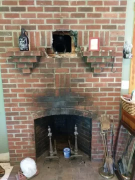

Thought picture might help.

The plywood under the brick is suspicious. That may be the mason's concern. See if there is an NFI pro in your area to evaluate. If the fireplace is improperly constructed then a freestanding stove there may be the safest option.

Not sure how they got the Tee Connector in there, but the removal of the Class A pipes need to be removed. Then getting behind the brick wall to rebuild the chimney. The chimney will need a stainless liner with insulation. Again not sure how large the inside of the chimney flue is, but most fireplaces will need square or rectangle liners, but depending on the fireplace opening and height of this chimney, maybe a correct sized round liner might work.
I have feeling the guy that had the house before you was starting a project to install a wood stove.
If it was me, I'd totally demo that and build what I want it to be. A small, crappy-built, fireplace is worthless to home value any way. Tossing a 1/2 ton of bricks in the trash is nothing to cry over either.

Plywood under the brick. Looks like a veneer job. I was very happy to demolish a masonry fireplace and chimney for a proper piped install of a real woodstove.
Guys it is very normal to have a combustible wall between the chimney and the face of the fireplace. There is not nessecarily anything wrong with it. I am sure there are mulitple options to make it work either as an open fireplace or with a stove.

Question is did it have enough brick between it and the flue. Were the combustibles 2" clear of the brick?

Yes you are absolutly correct. And there probably isnt enough clearance. But there are still options even if there isnt.
The black soot on the bricks may point to a draft problem with the fireplace. That’s probably why the previous owner was trying to install a stove, if I had to guess.

An insert or stove with an insulated liner. Or an insulated liner big enough for the open fireplace but like mentioned before the smoke staining makes me wonder about the design of the fireplace.
