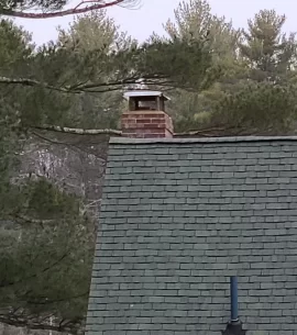

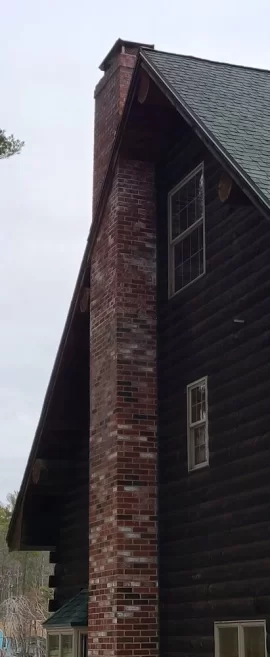

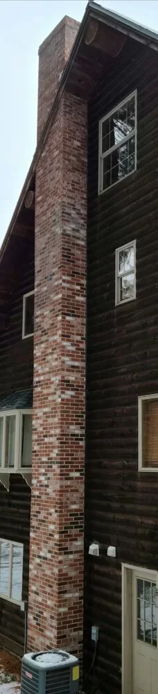

The chimney is very tall. I am attaching photos. The angle makes the top look even or below the peak, but it is actually close to the 2 feet if not right at 2 feet of the top of the roof. I can take a photo from a different angle tomorrow if that would help? I had a cap put on by a chimney company and they said I didn't need to make it taller, but I am not overly confident that is the case as I don't know what else could be causing the problem?

What does the chimney have for a liner? Is there a cleanout on the masonry chimney?
When you go to open the door, are you opening the primary damper and key damper first?
I believe it is a clay liner, and it has a cleanout at the very bottom of the chimney on the outside of the house.
I do open both dampers before opening the door, as well as a sliding door in the house about a foot.
How well sealed is the cleanout ?
Any way to measure the inside dimensions of the liner?

Do you have a pic of the new chimney cap? Many people have issues soon after a cap with mesh/screen is installed as they are notorious for getting plugged quickly if burning marginally seasoned or wet fuel.

Looks like your pipe is installed upside down. I have an nc30 and it’s a fine barn heater type stove since it likes to run hot. That chimney looks huge.

I took a photo this morning of the new cap, see attached. Is the huge chimney an issue?

The chimney cap is large and so is the chimney but we can’t see how big the actual clay liner is. Your stove has an upper limit of actual flue liner size that it is designed to dump into. If the clay chimney liner is too big you can install a stainless steel flex liner to match the stove.
