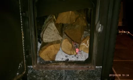

Just goes to show you that every installation is different. I could get 9 hours of burntime from my heritage loaded with red alder/cottonwood/maybe some fir but all low btu junk. You've got to load it full and get the draft shut off though.

Get a different stove or fix your setup so you get the burn times you should be getting have you tested the draft? Have you installed a key damper? What wood are you burning? How full do you pack it? Have you checked for leaks?
My wood is usually medium soft. I have a lot of fir, some alder and maple, some fug wood. I only open up my draft when I start the fire, otherwise it is kept fully closed.
