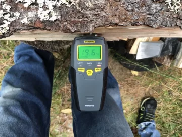

Highest MC tested was 19.6%
First pine fire, ever. Happy to report the house is still standing even after several of these unpredictable, dangerous experiments with burning pine...

I am here to publicly thank @Woodsplitter67 and to agree with what others have said: this design works, and it works well.
I want to echo Coalescent's thank you to Woodsplitter67. My "kilns" aren't as pretty as theirs but the principal is certainly sound. Hickory in my first set of 4 pallets, covered on 8/10 are now at 14%, beech in the same batch is @ 12%, as is the hard maple, they are ready to be moved into the woodshed. Pulled a couple of hickory splits out of the second set of 4 pallets, covered on 8/30, and they were @ 16% & 18% only 6-7 weeks in. Not to shabby considering they didn't have the advantage of the "summer" heat. I have 2 more batches covered this month, hope they get below 19%-20% before winter sets in. Blocked up another batch today. Including a few more pics of the work in progress over time: for reference, the top of the fenders on the smaller tractor are a bit over 5' high, hood on the sweet allis is over my head.

I want to echo Coalescent's thank you to Woodsplitter67. My "kilns" aren't as pretty as theirs but the principal is certainly sound. Hickory in my first set of 4 pallets, covered on 8/10 are now at 14%, beech in the same batch is @ 12%, as is the hard maple, they are ready to be moved into the woodshed. Pulled a couple of hickory splits out of the second set of 4 pallets, covered on 8/30, and they were @ 16% & 18% only 6-7 weeks in. Not to shabby considering they didn't have the advantage of the "summer" heat. I have 2 more batches covered this month, hope they get below 19%-20% before winter sets in. Blocked up another batch today. Including a few more pics of the work in progress over time: for reference, the top of the fenders on the smaller tractor are a bit over 5' high, hood on the sweet allis is over my head.View attachment 249746View attachment 249749View attachment 249747View attachment 249748.
Thanks fo posting. Im glad to see this working out for you. I like your stacks i would hope that you will keep posting your results. The seasoning will slow as we get closer to winter, but you will see results.. please post what they are..
