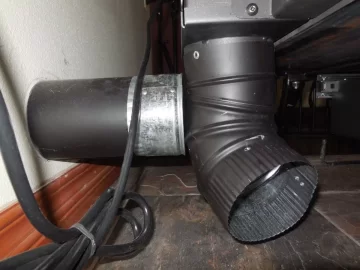

But then I was left with what you see in the photo: the need for a really tight elbow turn given where the dealer had punched the hole through the wall. The former elbow was properly placed if the plan was to shove one end high up into the stove. But with the adapter, the elbow is in the wrong spot.
I'm wondering if a tighter elbow can be fabricated. I've sent an e-mail to the dealer to see if there's anything he can do. Another option would be to drill a hole through the hearth pad and the floor, runing the air pipe straight down and out through the crawl space. But if a tight elbow could be created or a flexible but adequately heat resistant flexible pipe could be found, that would be my preference. I'd rather not make holes in a hardwood floor. When I pulled the cap off the pipe coming through the wall, there was plenty of cold air flow.

I would is flex corrugated duct pipe. You may have to cut the pipe sticking out of wall back a bit, but flex will work and is fine for outside air intake.

Ah OK. Yeah flexible dryer vent would do it. Though not legal for dryer vents in most place anymore. And finding it that large won't be easy either. Get a piece from the duct work section in the back of Lowe's. Same thing that turns into floor vents. Or just rip the top two sections off of that elbow. You won't believe how easy they are to tear apart.

I looked at that stuff today but it didn't seem to make a tighter bend than the rigid pipe I've already got. Unless I ran it around in a big loop like a figure eight, but that would have to cut down on airflow.
The flexible stuff doesn't seem to elbow that tightly but ripping a section or two off the elbow might do the job. Will see if that might work. Would you recommend cutting with tin snips?
They sell those close 4" adapters at any big box store such as home depot, menards, lowes.. etc.. for about the same price. Atleast you don't have to wait for it that way. They will be with the dryer vent hose.
Thanks. Will give it a try tomorrow unless I can manage to cut down the existing elbow tonight.
You just pull the elbow apart. You will be surprised how easy it falls apart. The reason nobody should ever use one in a chimney. You will end up with one end with an angle on it. Two words, silicone tape.
Yeah, I guess it would no longer make a 90 degree angle if a section were pulled off.
Two sections in that space you are working with. For what you are trying to find out the leg cut out of a pair of pantie hose would give the answer. Or a PVC elbow. Just to find out if it changes anything.
