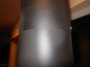

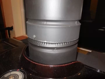

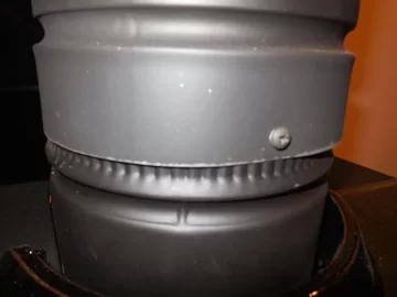

Do any of these connections look suspect?

Ok, that's helpful. I guess I could also put some in the cat probe hole to test if that's the source of the leak. Am I off base?
Stove rope gasket and a hose clamp at the junction of the chimney and the flue collar of the stove. Not pretty if it is sitting out in the room but it will answer the question.
I'm not sure how one would attach the gasket or even where it would go. Are you saying you would wrap it around the outside of the pipe at the junction?
It shouldn't hurt to try a little there, but there is a bigger issue if you are getting leakage from that spot. Windy night and temps in the low 50s aren't helping draft.

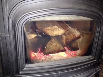

I find it odd that your glass is so dirty. My chimney is minimum height and the glass is rarely very dirty. On average it's the cleanest glass of any stove Ive ran to date!
That seems also odd. Our glass is typically cleaner than that but that looks great for a cat stove. Most folks don't seem to be getting that clear glass until winter burning with the stove working harder. Does the other stove or previous Jotul(?) have trouble keeping a clean window?
My other stoves did ok. But once they got cruising I'd have to turn them down, causing dirty glass this time of year. The Ashford is a bit dirtier this time of year, but not bad at all. Once it gets cold I just don't need to clean it. My King wasn't like this though, it seemed to be like others are experiencing. By design, I think the Ashford/Sirrico stoves stay much cleaner.
Good to know. I just burn hot shorter fires with less wood at this time of year. Glass stays very clean and the mass of the T6 continues to heat for hours. How frequently do you dump ash in peak heating season?
Ohh, probably once a week. Might do 2 pans full? That's the beauty of the plug design! With the grate in the floor I found that I had to dump more often otherwise I had a mess.
