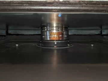

Hi All,
Does anyone have any tips or checks for identifying and fixing a leak in my setup?
After doing my two test burns (used stove's already broken in), I kept smelling emissions, faintly, and it was hours after the last time I opened the door. CO alarms on the ceiling have been silent. I was able to smell faint emissions from between the top of the stove and the block-off plate. I can't see any smoke. Space is tight and during install, I needed to remove the stove collar and assemble the stove collar, the appliance adapter, and the liner, then pull it all down by the collar and bolt it down to the stove. The adapter looks not perfectly seated so I'll try to tweak it and hopefully the adapter tip didn't get bent. The lighter test near the seams don't pull the flame in. The whole air pathway should be under a solid negative pressure especially when running hot I'd think so not sure why even if something were to have a small gap, it would leak out.

The first burn had more of a "hot dusty metal, with a hint of chemical" and I figured it might be seasonal break-in like dust and maybe liner and block-off insulation (roxul) getting exposed to heat the first time.
I was thinking maybe the label residue as well. It just seems to have that clean burning wood ember smell to it.
So far it's not tapping straight so may need to remove screws,,, I'm hesitant cause this thing was a bear to get in place. Many "serenity now"s were exclaimed.
Well I removed the screws joining the collar and the appliance connector and tried to re-seat into the collar. Mildly better, but still looks at a slight angle.
3rd burns a charm - I wasn't able to perceive any exhaust or other odors.
