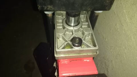

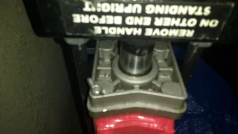

The seal on my electric splitter has an oozy leak at the seal on the ram. I noticed an oil spot on the concrete, so I cleaned it up real nice, and stored it vertical, instead of horizontal, as I usually do. The oil oozed out around the seal, even though the oil is lower in the reservoir than the level of the seal.
Two questions, and the first one is the important one: Can the seal be repaired?
Second, how is the oil in the reservoir creeping up the ram cylinder to leak out, when the level is well below the seal?
A couple of pics, from two different angles. The oil is collecting just above the wing nut, in the "honeycomb", in the second pic, when stored vertical.

I'm guessing that the four castings that are around the ram are bolt holes and the bolts are accessed from the back of the ram? I've never had an electric splitter but that face plate should come off and there is likely a metal cased seal that goes in from the rear. Another thing to try is take a very thin piece of plastic (old film negative works best) and slide it around the ram to clean any debris that mat be stuck in the seal. I do it all the time with motorcycle forks.

I'm trying to think what work as a substitute for the film. But yes just form it around the ram and slide it back and forth between the seal. You may be able to use a thin credit card sized card. Like a plastic insurance card or something. Not sure. I always use negatives. It needs to be pretty thin. As an alternative you could take it apart and clean the ram and seal to see if that cures it but by the time you get it apart you might as well put a $3 seal in it.

If you haven't solved the leak problem, here's a thought. I can't tell what brand of splitter, but it looks like one of the 5-7 ton units of which there are several similar to it. On my splitter and other similar units I've seen, there is a wingnut that should be opened about a turn to prevent pressure from building up in the hydraulic system. Make sure the nut is open and run the splitter. That may solve the problem.
There is a wingnut, and I always open it to run it. One time I forgot, and 2 or 3 small easy splits later I remembered, then opened it. I think it was leaking before that. I believe it's just a little ooze from the dipstick hole, there is a copper crush washer there that is probably not up to snuff anymore. It's such a small ooze, I am barely motivated enough to order a few replacements. Eventually I'll get around to it, and report back whether that fixes it.
