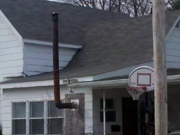

I spotted this install across the street while fighting a house fire the other day. This guy obviously didn't get a permit and may very well be the next fire call :ahhh:

Had one like that last year right behind me. He actually set the elbow on tarpaper on a shed roof. I had the fire chief stop and warn him but there is nothing really we could do. You can't pass law's against stupidity.

Perfectly fine. Nothing to see here people, move along.
You should talk to this guy, see if you can talk some common sense into him. If he doesnt listen, you have trucks..ropes and can make a lasso.
The basketball hoop indicates there is a child or children there.
I see the eves trough with the downspout is right above it, would that be for cooling?
Yes, you are right. That will be my next step. It is a violation of codes in the city, but prosecuting this kind of violation is not as easy as some might think. The common sense visit will always get it done quicker than a citation. Hopefully with Spring almost here, I will have some time to get this fixed. The other issue that usually prevails in situations like this, is that there is no money to do it right....the reason they are burning wood and installing like this in the first place.
Honestly guys, more often than not the folks around here who do that stuff just aren't interested in hearing about it. They've "been doing it that way longer than you've been alive, son," and just aren't interested. Unfortunately some folks have to find out the hard way.
Yes, I thought that was very thought out by this fellow....
At least they didn't mount the backboard and hoop on the stove pipe, they were very careful to maintain a safe clearance.

From what Im looking at chief, the ONLY way youre gonna get anywhere in that situation is if you provide, some if not all of the labor, and the finances. Good luck.

Maybe no need for truck and rope. It looks like it's ready to rust through soon.

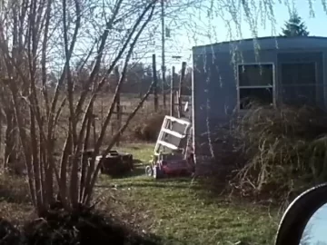

You can't see this one very well but I couldn't get any closer without risking getting shot.

Must steam up nice in the rain since the downspout flows right on to the elbow.
I may be wrong, but that could be the camera angle. It seems odd that they would carry the shed roof over to where the flue pipe is. I think the downspout is actually a good couple feet to the right of the smoke pipe.
So really, what are the problems, for one such as I who doesn't know all the codes?
Is it that an exposed pipe is required to be stainless/insulated, or that the thimble is not adequate?
Too close to the eves?
It looks like the pipe is stayed with wires.
If that downspout does hit the pipe, its just the redneck smokescreen for the gub'mint aircraft.
