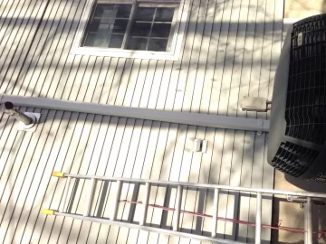

Here is a picture of the pipe outside. Don't think I can do the leaf blower trick to suck it out because its so akward.

You need a taller ladder and a paid up insurance policy._g
Reactions: GMadd
Aw heck, that one is easy to get to! It's just made for the leaf blower trick.
How stand on the ladder?
Yes, Just run a ladder right up there alongside the vent.
Some people make adaptors from the vent to the electric leaf blower suction from plumbing fittings and secure the leaf blower in place.Then you just plug in the leaf blower, stand back and watch the soot and ash come out, you don't even have to stand up there while you do it.

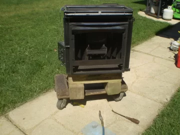

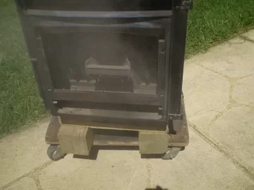

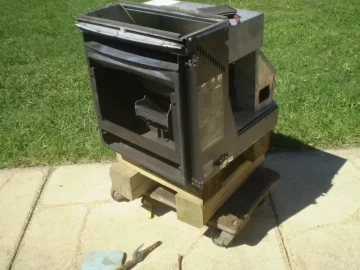

Leaf blower will never do a job better then taking the stove outside and giving it a once over with compressed air.

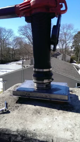

You can clamp a leaf blower on there. Here is mine. [Hearth.com] Let's take this thing outside……
