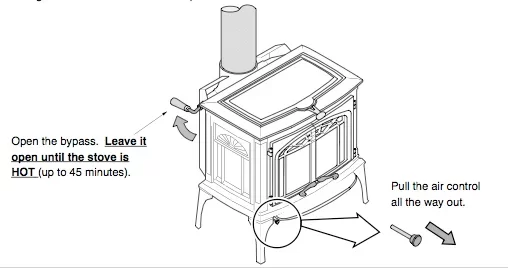

Just to make sure I'm getting the terminology correct for the areas I'm referring to, I've attached a diagram. below. [Hearth.com] Leyden problems, I'm stumped...
I've checked all the key areas but I'm obviously missing something; air has to be getting in somewhere :-/ Is there another area on the stove I should be checking?
Something I'm wondering is if the small swing plate attached to the air control arm in the back / bottom of the stove is attached with a nut that could back off from heating / cooling allowing the plate to sag and not fully cover the intake? The area is covered with heat shields and I'm not able to inspect without taking things apart. Any suggestions?

Have you inspected the combustor refractory assembly? It sounds like it may be breaking down. Do this carefully, it is fragile.

I'm not sure. If the wood gas is sucked through a different channel it may disrupt the burn pattern in the combustor. An inspection of the bypass assembly would also be good to make sure nothing is warped and that the bypass closure is tight when engaged.
Waiting on a schematic from the dealer showing all the parts I am not able to see without taking things apart. When I get home tonight I'll remove the combustor assembly to see if there's something going on there. The bypass plate appears to be making good contact all the way around with the gasket, but will double check that as well. Will let you know what I find out (if anything) :-)
