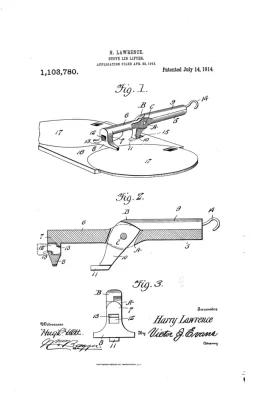

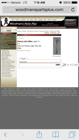

I did something stupid and broke my special lid lifter for our wood cookstove this morning. I can't find another on the internet any ideas where to get one?
It is regular lid lifter but has an arm on each side. It lets you pick up two kids and a middle section at once to load wood. Its awfully annoying loading wood without it.
