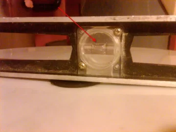

I was just servicing by boiler when I noticed a horizontal bulge in the shape of a finger near the aquastat on the 45 gallon SuperStor Ultra Tank. See pic 1 below:
I like to maintain mechanical systems and do not only PM but also preventative maintenance to avoid big problems.
My oil man suggested that if the tank was not installed close to being level then undue gravity stress could be put on part of the tank due to the uneven weight distribution and their may be warrenty issues in this case.
I installed the tank on a cement pad that I leveled completely since the cement floor was old and maybe not quite level.
So I checked it anyway and it was right on level!! See pic 2 below.

So I carefully explained to the support person this issue. I would like to prevent any further damage if possible.
He assured me that the Stainless Steel Tank inside can take 300 PSI and not to worry about any leaking.
He also said he has heard of this issue which sometimes leads to a crack in the plastic shell. The problem is caused by the closed cell foam insulation "Re-Energizing" as he put it! This may be due to a damp basement or temperature difference in the Hot Water inside the tank and the Temperature outside the tank.
So HTProducts recommends in this case and/or a cracked plastic shell for the home owner to purchase a hot water tank insulation jacket and install it around the SuperStor tank.
Then provided the customer has all the paperwork on the SuperStor and the receipt of the insulation jacket, he may call up HTProducts for a RMA # (Return Merchandise Authorization) and be reimbersed for the full cost of the insulation jacket not including installation.

Sounds like they don't think it will leak and they want you to cover it up so you cant see it .
I have two superstor tanks, 120 gal and 40 gal. They were both replaced for leaks. The 120 was used by a large motel and the plumbing supply (where I found the tank) thought that the combination of long heavy runs of pipe and hard service caused premature failure. I am likely to believe them since the leak was on the outlet. An easy repair for me. My planned service for this tank is solar hot water.
The 40 gallon tank had nothing wrong with it, the aquastat well was bad.
Point of the story is this though; the plastic casing on both of these tanks was in worse shape than yours, by far. I am not worried.
As to the level thing, yeah, that is B.S.
I installed hundreds of hot water heaters and tanks working for my brother, a Mass licensed master plumber. We always set the tanks on blocks or bricks, and leveled them by eye at most, never a problem.

Well I talked to my boiler analyst this morning and he gave me the scoop. After the government made companies switch to CFC Free foam is when the trouble started. The new 2" thick water blown formula would re-energize and go from 2 inches to 3 inches and crack the shell. It looked like the elephant man after a while!! Since then they have changed the formula so it does not happen nearly as much but it does still happen some. The cause is the real hot water inside condensing the cooler air on the outside creating the mosture to re-energize and deform the foam.
That is why they recommend the insulation blanket, since there is no vapor barrier the insulation blanket with foil will insulate the exterior plastic shell and foam from severe temperature differences and stop the elephant man effect!!! Since the heat loss is already less than 1/2 Degree F heat loss per hour the blanket will help some but not alot.
