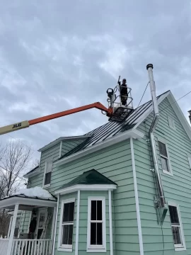

We wanted to put the stove in the corner of our living room, on the first floor of a two story house, and we decided that rather than cutting through two ceilings and the standing-seam roof, it would be better to send the stovepipe out the wall and run a class-A chimney up the side of the house. After reading a few posts here about notching soffits vs. installing an offset in the chimney, I decided on an offset to clear the eave. Snow sliding down the roof is a concern where we live, and I didn't want the chimney taking the brunt of it.
We ordered the stove, and I set about buying the double-wall stove pipe, elbow, through-the-wall kit, wall brackets, roof brace and about 20 feet of Ultra Temp chimney. All-in, the parts and stove came to just about $5000, including shipping.

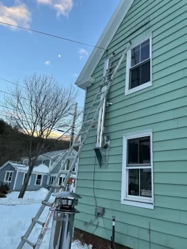

Once I had the location for the hole set, about 6 feet off the floor, I used the pieces of the wall thimble to trace big circles on the wall and on the siding outside. Then I used a 2-inch hole saw and punched through the sheetrock and plaster, and used a battery powered reciprocating saw to enlarge the hole. My wife manned the shop vac to wrangle the dust and the loose-fill cellulose insulation that fell out of the wall.
Once I'd pressed the inside part of the wall thimble into place, I moved outside. Standing on a ladder, I cut away the aluminum siding with aviation snips, then returned to the hole saw and sawzall to cut out the hole. I'd picked a two-day weather window when it wasn't going to rain or get below 40 degrees, but I remember thinking: "Now you've done it. You just cut a foot-wide hole in your wall. In Vermont. In the middle of February."

The installation instructions for the base plate and support were pretty straightforward; I'd made sure the framing of the wall met the specifications, so all I had to do was screw in about 10 2-inch screws to anchor it to the wall, make sure it was level, install the tee, and begin adding sections of chimney. Once I got higher than I was comfortable with on the ladder that I'd borrowed, we rented a boom lift for the installation of the two 30-degree elbows, the 2-foot section of offset, the two remaining 4-foot sections of chimney, the cap and the roof brace. I tightened and re-tightened all the screws, and I applied silicone around the exterior section of wall thimble and around the piece of lateral chimney that penetrates the wall.

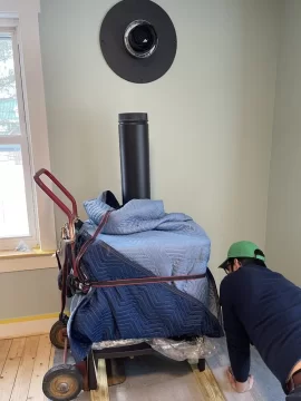

With the chimney installed — man, what a relief that was — it was time to wheel the stove into place and assemble the stovepipe. When the stove arrived, we'd broken down the crate and strapped it to a handtruck, so all that was left to do was to pull it up a ramp over two steps and into the house. With just the two of us, this proved ... a bit difficult ... but we managed to keep all of our fingers and toes.

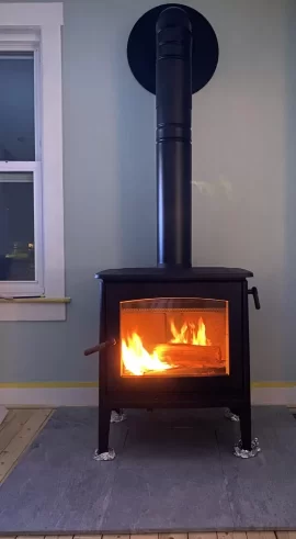

Since the Hipster only requires ember protection and not a hearth with any R-value, we bought a few 16" square soapstone panels to serve as our hearth pad. They were cheaper than going with a custom-cut slab of slate or soapstone, and were easy to manage.
Assembling the stovepipe was difficult, since I found the Selkirk DSP instructions a bit sparse, but eventually we got everything lined up and in place. If you're using a 90 degree elbow to head out the wall, an adjustable section of stovepipe is essential for the vertical run.
We followed the stove instructions and made a very small fire at first, letting it cool back down to room temperature as a way of helping season the soapstone in the stove, and we put down some aluminum foil around the legs, but we did not have any liquid leak out. We're now into our third day of keeping the stove going, and I have loved experimenting with the air control and finding how to keep the stove running hot but not too hot.
Using this set-up, the draft and backpuffing problems that others have described with this stove have been nonissues for us — though I make sure to engage the bypass, open the air control, and crack the door a minute before reloading.
