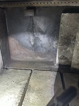

Heat accelerates oxidation, so some rust may be visible inside the firebox on some stoves. What stove is this? Rust can form due to high humidity or a water leak, especially at the end of a humid summer when the house is air-conditioned. Is there rust currently on the stove? If so, where?
Regency i2400
