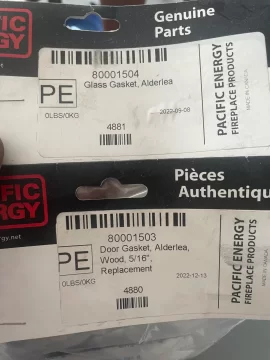

Here are the door part numbers.
  • [Hearth.com] Do I need to use certified dealer for inspection?
