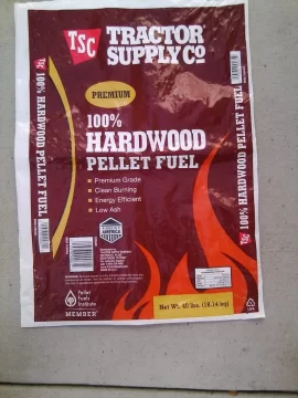

01323800612 is a dark red bag, TSC branded Lignetics hardwood pellet. I've been happy so far.

Could someone take a picture of the TSC's Lignetics bag? So I can identify more easily at the local TSC's around me. Thanks
[Hearth.com] Lignetics Pellets and TSC [Hearth.com] Lignetics Pellets and TSC You can't tell by looking at the TSC bag, what kind or who bagged them. The bag all look the same, no matter who bagged them. You must take note of the UPC number and search it on the web, to find out who bagged them. The bag is the same for all who bags them.
