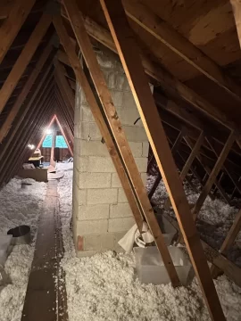

I'm including pics of the fireplace and the chimney in the attic. The chimney flue is quite large so I don't think insulation is going to play a huge part from a safety perspective (but please correct me if I'm wrong).

I’m not a professional but you should definitely do insulation- whether a preinsulated liner or wrapped on-site. The purpose of the insulation is for protection from radiant heat from liner. The slight increase in draft is nice but not the purpose of the insulation. The installer really should know that. I understand that the chimney is large but still…. When I see your picture of the chimney in the attic, it’s not all that big. Regardless, you won’t regret the insulation.

Code says unless you have 2” clearance to all/any combustibles round the entire chimney structure you are required to insulate. I can’t tell from the picture in the attic but guessing you don’t have 2” gap around the block chimney.
So two or three. Plan on wrapping a piece of split 8” stove pipe around the liner where it comes off the stove. It looks better

Did your contractor say if the 2" to combustibles was met? That is code and if it isn't met than it must be insulated. We are talking about $500. That isn't worth it for peace of mind?
