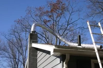

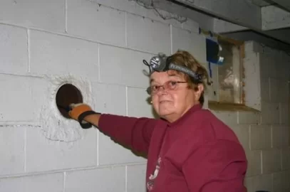

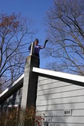

I guess an explanation would be helpful. First pic is the liner at the point at which it stopped cooperating; second one is Lorraine at her post; third is yours truly with the liner down the flue.
Today I cut off the excess and attached the topside hardware.
