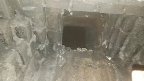

I jus pulled the damper and its 11x11

11x11 inside? If it’s a straight shot to the roof this makes it easy to install a insulated liner pre or wrap insulated flex liner. 90-45 bends in chimney sometimes needs a liner puller.
