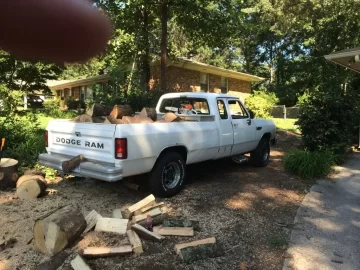

By the way, nice dodge, I think I drive its grandpa ;lol

I am going through major trailer envy. ;sick

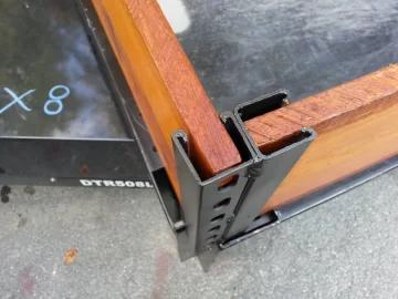

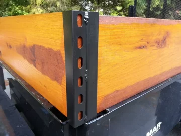

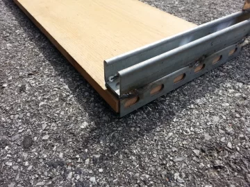

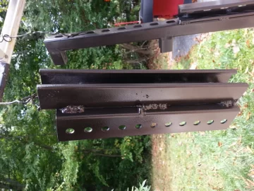

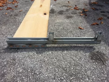

The trailer is a 5x8 Bri-Mar.. cost $3000. The idea is to split directly into the trailer and dump at the stacking area. This is the second year with the trailer and believe me it's not just the wood that it has helped so much with.... I made lots of friends LOL
But using this method it saves on handling and over the years, my back. I built the vertical rails that hold the oak side boards from electrical "strut" channel. Those oak boards came from an estate cleanout. The fellow cut them from a tree on his yard and planed them. They were perfect in size for this application. Stroke of luck I suppose.
