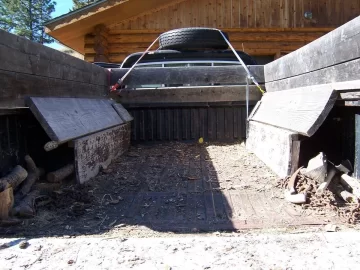

I boxed in the area in front of my wheel wells so the load does not get jammed in front of them. [Hearth.com] Loadhandler?

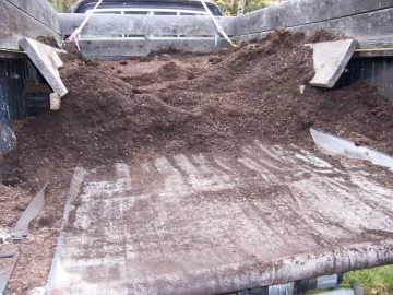

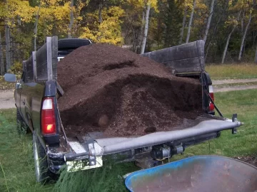

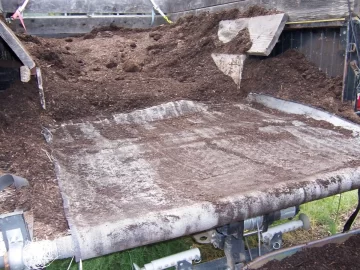

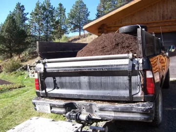

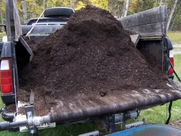

It just so happens I am currently using my Loadhandler to bring in a load of compost to my garden. I have 3 yards on that weigh a little over one ton. The pictures show the sequence from unloading from the back to dragging the front out.[Hearth.com] Loadhandler? [Hearth.com] Loadhandler? [Hearth.com] Loadhandler? [Hearth.com] Loadhandler? [Hearth.com] Loadhandler? [Hearth.com] Loadhandler? [Hearth.com] Loadhandler? [Hearth.com] Loadhandler?
Nice. Those boards over the wheel wells really help.
Is the compost left in front on the last picture because it was a high pile? Is there a way to get around that? I read a tip on the web: something about folding the fabric on itself, but I didn't understand fully.

4) The wheel wells are some issue. You can either build the fancy wood planks as seen above or just deal with the spillage around the wheel wells. Either work as long as you're dealing with a load which won't 'lock in' around the wheel wells. I've been hesitant to try the load handler with things like firewood as I feel it would 'lock in' and I wouldn't be able to move the load handler. I suppose if you stacked the wood with the rounds pointing 'east-west' and were careful to avoid the wheel wells, it might work, but I've never been willing to give up that much bed capacity for an 'easy' load.
Yea, you have to really clean and wash off both the bed and the fabric between each load to lessen the grit. The more extra fabric you extend up the back of the bed, the more of the leftovers in the front you can drag, which I did not do in this instance.
