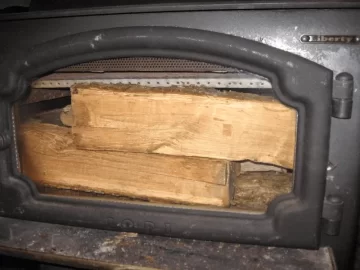

I did a trial load this morning while the stove was stone cold so I could move things around and put wood in and out of the stove without flames and coals complicating things. With the right shaped pieces and sliding the edges behind the steel front of the stove, it's possible to build a wall of wood right up against, but not quite touching the front window, like this:
[Hearth.com] Loading a Lopi [Hearth.com] Loading a Lopi
Is there any problem with doing this in practice? From reading other threads it seems my worries about breaking the window are largely unfounded (assuming I'm not closing the door on the wood). Are there any benefits to leaving more air space between the wood and the door?

I would hate to load that stove east/west. I have a similar stove, the Republic 1750 and I load 100% north/south. One, there's nothing to prevent a piece from rolling onto the glass and two I wouldn't want to go shoulder deep to load the back on a bed of coals.
Until you can get the length you need to go N-S, you can use the 'tunnel of love' method. Make a trench N-S in the coals and load E-W on that. Then air will be able to get back into the load through the tunnel.
Only time you will break glass is if your wood is sticking out and you slam a door on it. Log rolling off while burning won't cause any damage other than dirty glass.

I find this is a must for E/W loads. If I don't the wood in the back just lays there and smolders. With the tunnel of love method I find it works better if I leave a small space between the back of the firebox and the first piece of wood
Thanks for the replies! I had discovered the "tunnel of love" method and found it must be used with care as you can have too much of a good thing, especially if there's a lot of coals when reloading. It also makes a difference if you're using the blower or not, as the blower can take a lot of heat off the back of the stove and make it hard to burn the logs way in the back.
Strange, it didn't occur to me until I typed that, but it does seem the wood should be loaded differently depending on whether the goal is high heat with blower, or low heat long burn. I'm pretty good at loading for high heat and short burns (or so I think), this question was more about stuffing the stove full for a long overnight burn. So far I've had no luck having more than a coal or two left in the morning if that, and usually wake up to a cold draft coming down the chimney and an icy cold stove.

I never load my Liberty N/S unless I have chunk wood that fits, other than that it's always E/W loading, which is much more efficient in my opinion. The tunnel is required or your fire will just smolder.
Now, for how full. It all depends on a daytime burn where I tend to it every 1 1/2 hours or an overnight burn where I'm looking for 8-10 hours. As I load for a daytime burn I only throw in enough wood for it to burn 1 1/2 hours tops. This does two things, first it allows me to conserve wood and second it allows the wood to have good air circulation around to get a complete burn. If I have a very good bed of coals one log of about 4" in diameter and 20" in length will usually get me that 1 1/2 hour burn time, with the fan running, again with a good bed of coals. The overnight burn is somewhat different. I usually load it up with TWO large unspilt rounds that will take up the whole firebox almost right up to the window, and just under the secondary tubes. Once the fire is going I shut the blower off and pull out the air intake to where there is only about 1/16 to 1/8" of the air slot showing. This will give me a good hot fire, around the 500 degree range on the stove, and just over 300 degree going out the stack. I then go get a good nights sleep, awaking in the morning to a dusty glass and enough hot coals to easily get me going again in the morning.

Update: I've had two successful overnight burns this weekend with the draft still going up the chimney and a handful of coals left in the morning. It's not a lot of coals, but enough to rake towards the intake and light up some kindling with. Starting with a warm stove and not having to fight to get a draft going is the big win.
By simply not being afraid of loading wood too close to the door, the effective capacity of the stove is increased by 50% which makes a huge difference :-)
