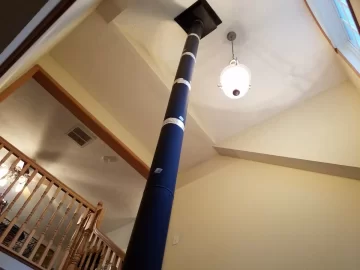

We bought this house last summer, used the stove in winter and noticed an issue. I Really have 2 separate issues. The 2nd probably doesn't have much of a fix but if you've got one feel free to share.
My main issue is with the loft and upstairs temp. I'll attach a picture if I can. The stove is in the entry, with the open staircase and single walled black pipe straight up to the ceiling/roof. The loft is way too hot. I'd love to spread the heat around, but I need to cool the loft. Is it the openness? The black pipe? No return in that part of the ceiling? My thoughts on those issues - swap to insulated pipe... block opening with curtains or a new wall... move return into the entry ceiling & run fan.
The stove has a blower on the back that we do run. Hvac guy said a booster fan on that return just inside the loft could damage the (new) furnace if the furnace fan was turned off. We do try to always run the furnace fan, but in-laws live in basement in-law quarters and say it blows cold air on them. Will probably close their vents and run fan this winter.
Issue 2 is the lack of heat in the basement.

So I had a couple thoughts, not sure how much help I can be though: Is the loft still too hot if you don't run the stove blower? Heat is going to rise no matter what, but I wonder if it would be more gentle if the air wasn't being pushed? Generally speaking I think you are going to have a hard time cooling the loft short of putting up a wall, as you mentioned. Another thought I had was about the height of the pipe--that seems pretty tall for single wall pipe. I hope the sections that are taped also have a few screws in them?
As far as the basement, some portable heater of some sort would be an option--though not a great one. Is there a way to use the central heating system to heat that space too? The good thing is that it shouldn't take much to heat a basement, the bad thing is that getting heat to go down is almost impossible.

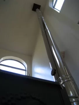

Your loft setup is exactly the same as ours...
[Hearth.com] Loft too hot

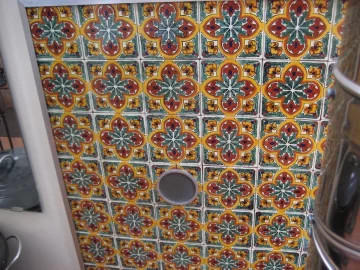

...except our stove is the only source of home heating. A long single wall flue is very efficient at transferring heat. We installed a small return air fan near the peak of the ceiling that ducts the warm air down the wall to blow on the back of the stove.

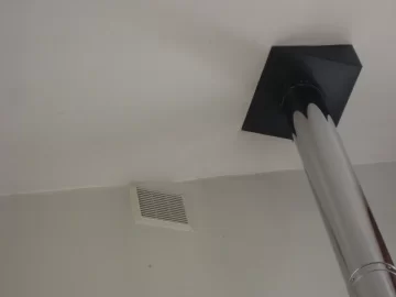

Since you have forced air central heating, relocating the return, if logistically possible, is a good idea.

You know, you could paint that return so it's completely invisible from one viewing angle...

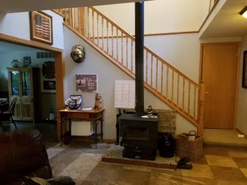

It might be easier to move the cooler air from the basement up, which may help the hot loft issue, might not. You need to get air flow or a convection loop going on to move that heated air from the loft.
Our house has a large open stairwell and even though the stove is a room apart, heat convected across the flat ceiling to the stairwell, overheating upstairs. I had to add a false transom to block the heat. That made a very nice difference and is entirely passive.
Would it be possible to relocate the stove? As you have found out, locating the stove at a large open stairwell isn't a great plan. The open stairwell acts as a chimney for the heat to convect up through. Then one requires a mechanical means to try and get the heat back down where it's needed.
